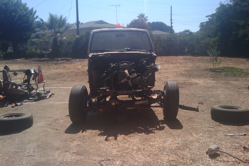

I'm building up a 1986 Trooper II 2 door.
I want this truck to be able to go almost any ware , basically i want to go to the Grocery Store if the shit hits the fan. I also want to keep it street legal for the time being.
My planed phase 1 is to do a SAS with a Dana 44 front and a Dana 60 rear, run 37" bead locks. Then flat bed the back, and build a cage. then to end phase 1 install some power adders to the little 2.3 (webber and header) And i want this project to be done for Glamis this year.
Here is the little beast
One more for good luck
Yes the snorkel does work.
Here is a photo of the in side of the cab

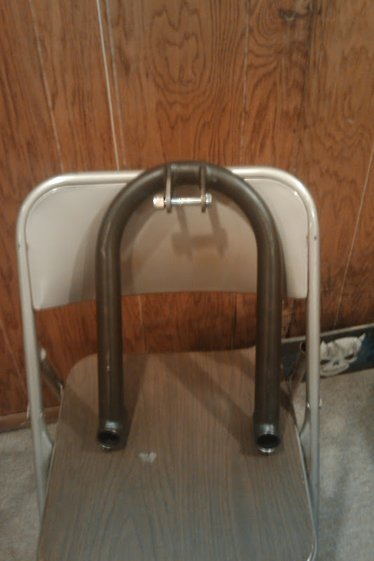

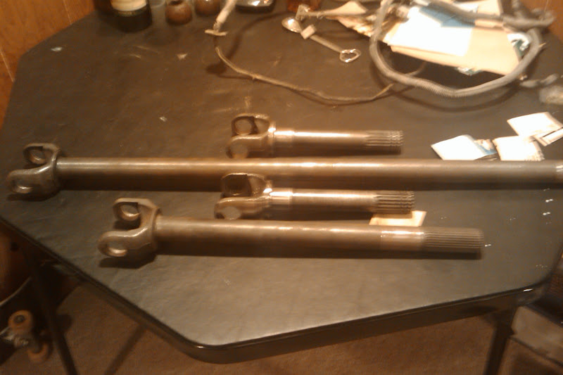

Here are a few of the parts that i have.

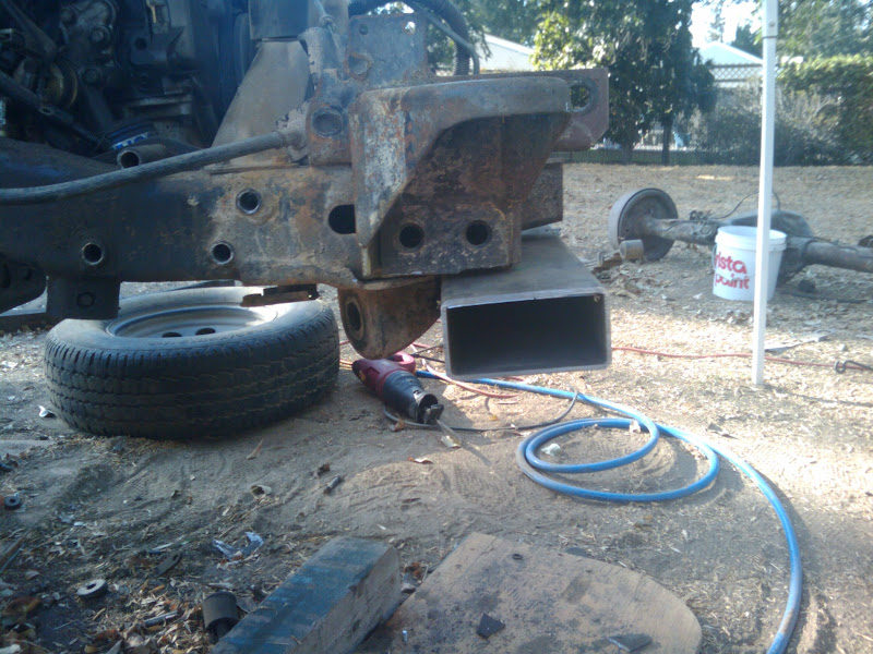

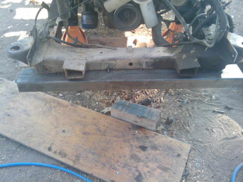

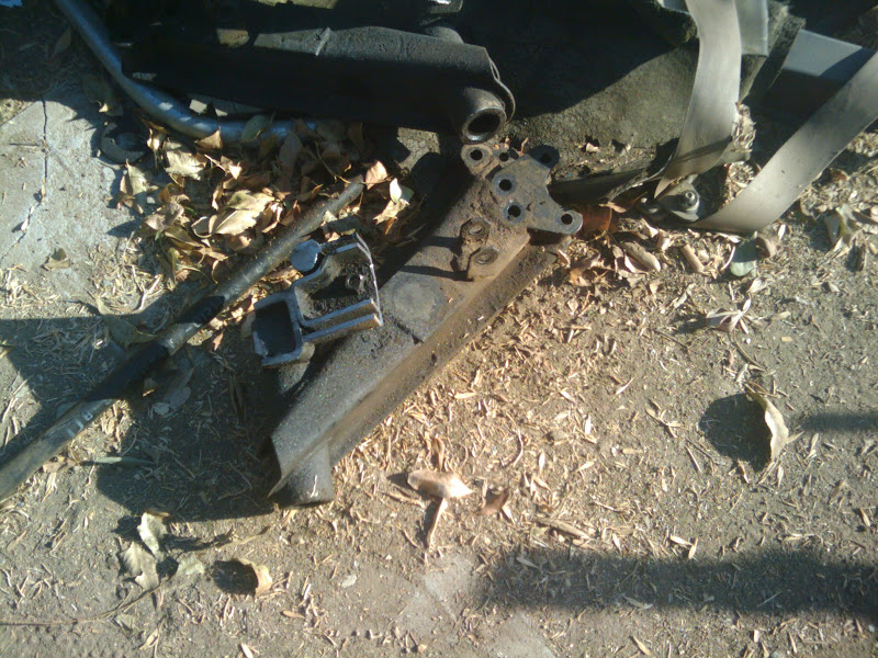

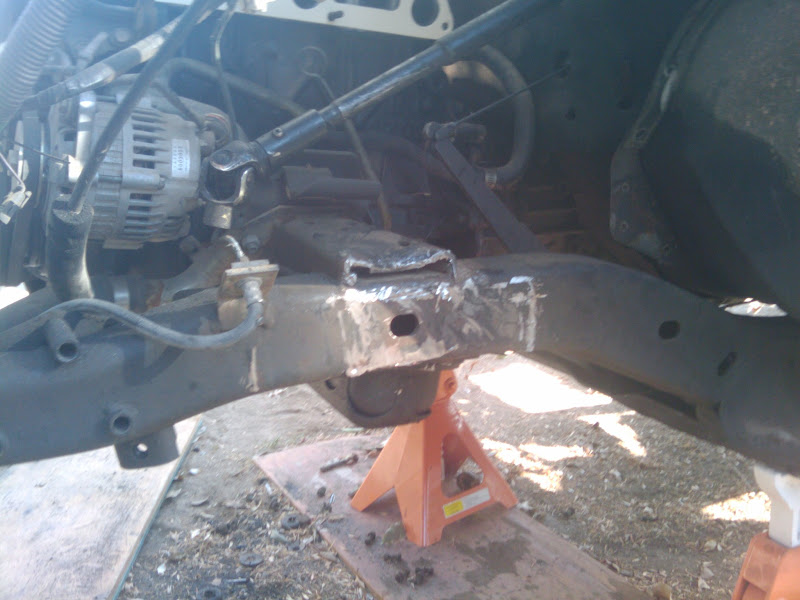

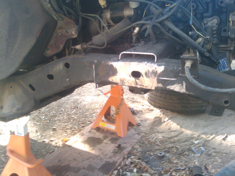

Here is a little bit of work that we have done to the truck this week. I have to get the Threds on the ubolts i have extended because i have a gap of about 2 inches so i cant mount the springs till i get that done.
Passenger side frame has a really clean cut.
Drivers Side frame was the side we started with so thats why it looks all messed up
This the front cross member that we are going to mount the suspension on
Here a side shot of the cross member

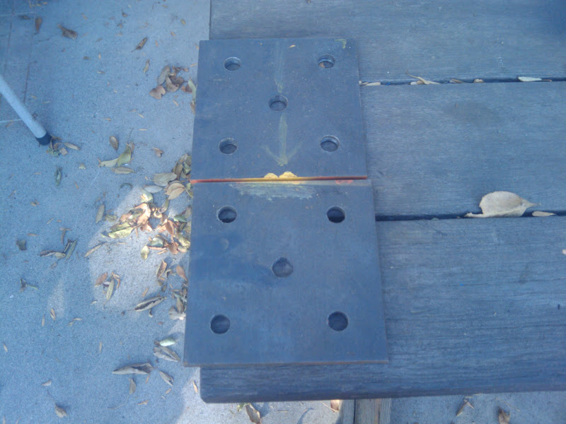

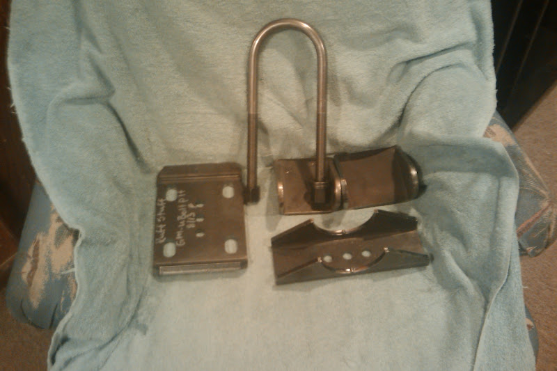

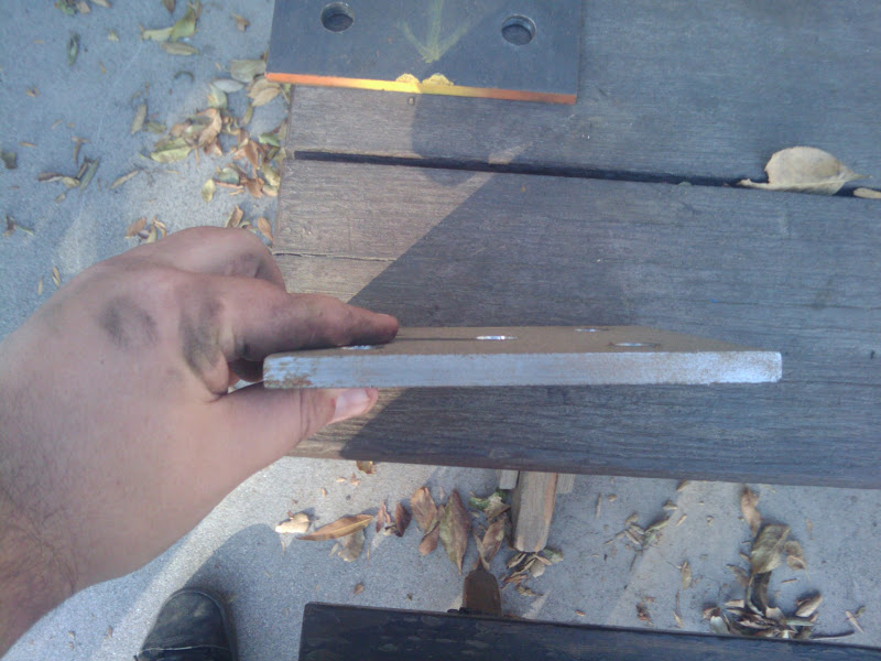

These are the brackets that we are gonna use to mount the axle to the springs. There home made cuz im a cheap ass
Here is a side shot of the bracket. It a 6x6 and 1/4 inch thick
Here are the GOD DAMN lower control arms. There are such a bitch to get off!!!!!
